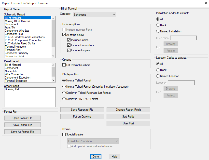

Report Format File Setup Dialog Box
Creates or edits a format file (.set) for a report. A format file defines the fields to include in the report, the field order, table options, and more.
Find
Command entry: AEFORMATFILE
List of Options
The following options are displayed.
Note: Options vary based on the report name selected.
Report Name
Specifies which report to run.
Format File
Open Format File
Browses to a format file to open and edit.
Save Format File
Saves a format file to use when running a single report or a group of reports with Automatic Reports.
Save As Format File
Saves a format file with a different name.

Category
By default, the report extracts schematic components. Select a different Category to run the report for one-line, one-line bus-tap, hydraulic, pneumatic, P&ID, or user-defined components. These components are each identified by a unique WDTYPE attribute value.
Installation Codes to Extract
Filters the information extracted for the report based on installation values.
All
Extracts all components regardless of installation value.
Blank
Extracts only those components that do not have an installation value.
Named Installation
Extracts only those components that have an installation value matching the value entered in the box. Wild-card characters are supported.
  • Drawing. Select one or more installation values from a list of values used on the active drawing.
    Note: If the Bill of Materials option Include Inventor Parts is checked, Drawing is disabled.
  • Project. Select one or more installation values from a list of values used across the project.
Location Codes to Extract
Filters the information extracted for the report based on location values.
All
Extracts all components regardless of location value.
Blank
Extracts only those components that do not have a location value.
Named Location
Extracts only those components that have a location value matching the value entered in the box. Wild-card characters are supported.
  • Drawing. Select one or more location values from a list of values used on the active drawing.
  • Project. Select one or more location values from a list of values used across the project.
Save Report to File
Opens a dialog box where you can define the settings used when you save a report to a file. Settings include:
  • File types
  • Whether to include title lines, time, date, column labels, and more
  • Whether to show the included lines on the first section only when a report contains multiple sections
Change Report Fields
Opens a dialog box where you can:
  • Specify the fields to include in the report selecting from a list of available fields
  • Specify the field order
  • Define the field labels
  • Define the field justification
Put on Drawing
Opens a dialog box where you can specify settings used when inserting the report as a table. Settings include:
  • Table style
  • Column width
  • Title
  • Layer
  • Section definition and placement
Sort Fields
Opens a dialog box where you can select the fields to use when sorting the report data.
User Post
Opens a dialog box where you specify which custom user-defined options to run when the report is generated.
