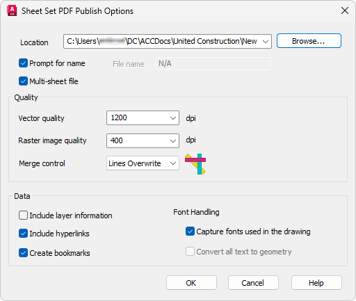

Publish Sheets in a Sheet Set
The Connected Sheet Set Manager supports all Publish features available in the Classic Sheet Set Manager.

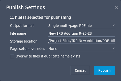

The following table outlines the differences between the Connected Sheet Set Manager and the Sheet Set Manager for Web when publishing drawings.
Option Connected Sheet Set Manager Sheet Set Manager for Web
Publish requires Desktop Connector (DC)
✓, local publishing
Local plot services are used for publishing. Drawing and referenced files are downloaded through Desktop Connector, and published PDF files are uploaded through Desktop Connector.
—, cloud-based publishing
Forge Design Automation (AutoCAD.IO) is used for publishing. It downloads drawing and referenced files from Forma Data Management and uploads the published PDF files directly to Forma Data Management.
Publish options Full feature support
Partial feature support
Publish to different formats ✓ —
Publish to local or shared network drives ✓ —
Publish to a physical device ✓ —
