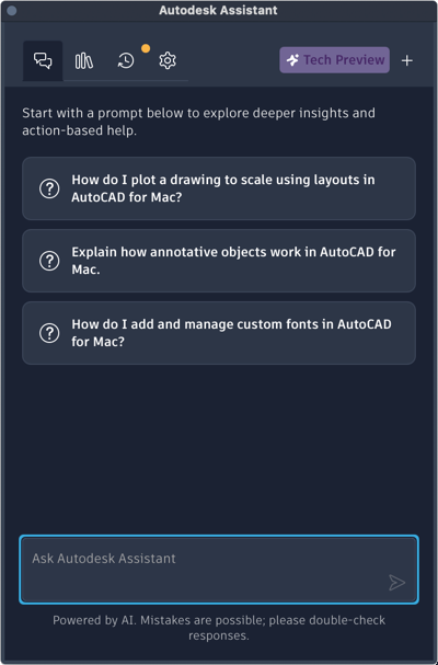

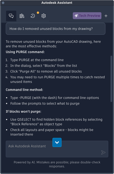

ASSISTANTOPEN (Command)
Displays the Autodesk Assistant palette, which provides AI-guided help.
Access Methods
Application Title Bar:
Menu: Help > Autodesk Assistant.
Note: Autodesk Assistant is available in a limited suite of products and languages. Functionality varies based on your license type and entitlements.
Machine learning searches through various sources and displays the best possible responses to your question.
