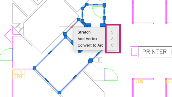

Shortcut Key Support for Dynamic Grips Menus
Dynamic grip menus now support shortcut keys in all localized versions. This enhancement makes it faster and easier to execute grip menu commands across different language packs.
When you hover over a selected grip, a dynamic menu appears with the available actions. Each action can be triggered using its corresponding shortcut key, consistent with the behavior in the English version. For example, for polyline vertex grips, you can type S for Stretch Vertex, A for Add Vertex, and R for Remove Vertex.
