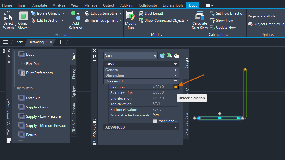

Object Elevation Lock
In AutoCAD MEP 2027, the Properties palette now allows locking of certain MEP object elevations after placement, ensuring that critical elevations remain unchanged during subsequent edits.
The supported object types include pipes, ducts, conduits, plumbing lines, and their respective fittings.
