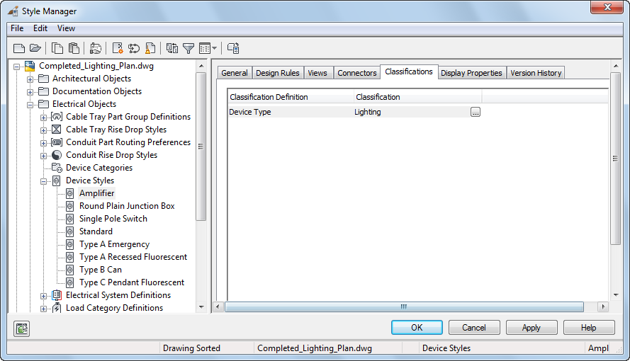

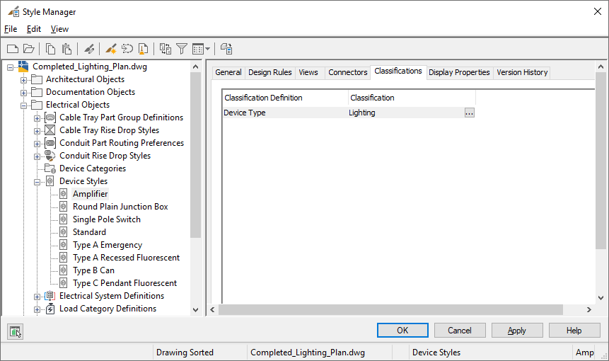

Classification definitions that apply to devices are displayed on the Classifications tab of each device style. When configuring a device style, this is where you specify a classification for the Device Type classification definition and for any custom classification definitions. Most of the device styles included with the software specify a classification for the Device Type classification definition.
Classifications tab of a 12 x 24 Recessed device style

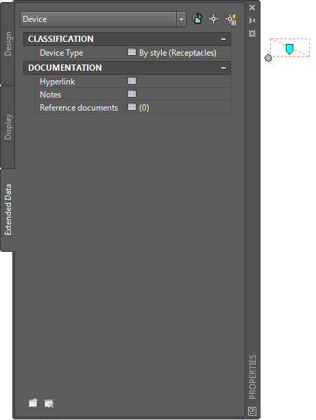

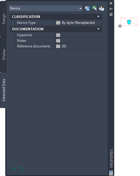

Because a device in a drawing is an instance of a device style, the device has a property for each classification definition in the device style. On the Extended Data tab of the Properties palette, you can view or override the classification for one or more devices in the drawing.
Properties palette for a selected 12 x 24 recessed light
To specify the classifications of a device style
  1. Open the drawing that contains the device style.
  2. In the Electrical workspace, open the device style by doing one of the following:
    • Click Manage tab Style & Display panel Style Manager . In the left pane of the Style Manager, expand Electrical Objects, then expand Device Styles, and select the style.
    • In the drawing, select a device that uses the style and click Device tab General panel Edit Style drop-down Edit Style .
  3. Click the Classifications tab.
  4. Specify a classification for the Device Type classification definition:
    • Click beside the Device Type classification.
    • In the Select Classification dialog box, under Device Type, select a classification.
      Note: Keep the classification for the Device Type classification definition the same as the value for Type unless you have added a custom classification that is more appropriate.
    • Click OK.
  5. Specify a classification for any custom classification definitions in a similar manner.
