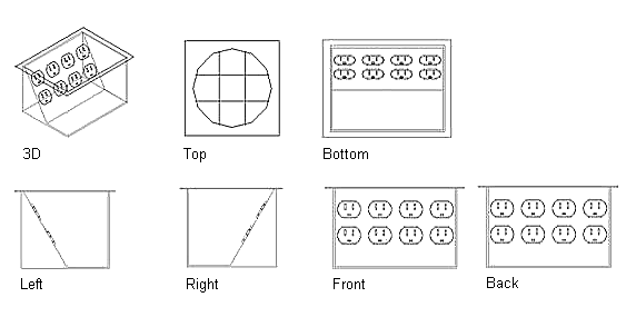

For each view of style-based content, additional view blocks must be created and assigned to a specific view in the style definition. The assigned views determine the appearance of the style-based content in your drawing. For orthographic views, you can create 6 plan/elevation view blocks and assign them to each ortho view respectively, or use a 3D model block to represent the ortho view. For information on view settings, see Defining the Views of a Style.
Orthographic view directions (for recessed double duplex receptacle)

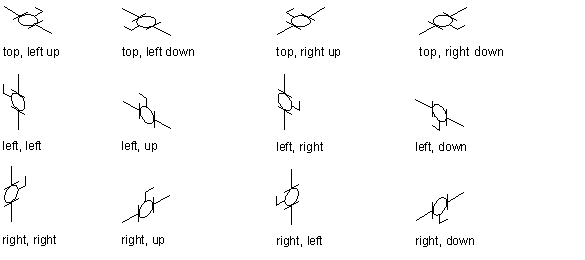

For isometric views, twelve view blocks should be created for each piece of style-based content.
Isometric view directions and orientations
When creating or editing style-based content, you specify the mode on the Views tab in the Style Definition dialog box. In Orthographic mode, you can assign view blocks to each orthographic view direction. In Isometric mode, you can assign view blocks to each iso rotation for each isoplane. For more information, see Defining Style Views.
