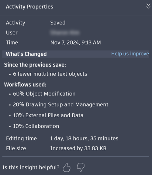

Introducing the What's Changed Insight
When you click a Saved activity tile in the Activity Insights palette, you'll now see the What's Changed insight in the Activity Properties panel.
This insight provides a high-level summary of changes made during each edit session. This can help you know what happened since you last worked in the drawing and continue where you left off.
The What's Changed insight is tied to the drawing, not to individual users, so all AutoCAD collaborators working on the drawing can create and view the same insights.
Generally, each What's Changed insight includes:
  • A list of changes for specific objects
  • A workflow breakdown based on command execution
  • Elapsed edit time
  • File size changes
Each insight includes a thumbs up or down feedback option, allowing you to rate its helpfulness. Additionally, you can provide more specific feedback through the Help us improve link in the What's Changed header.
We hope this new addition to Activity Insights enhances your collaboration and streamlines your workflow.

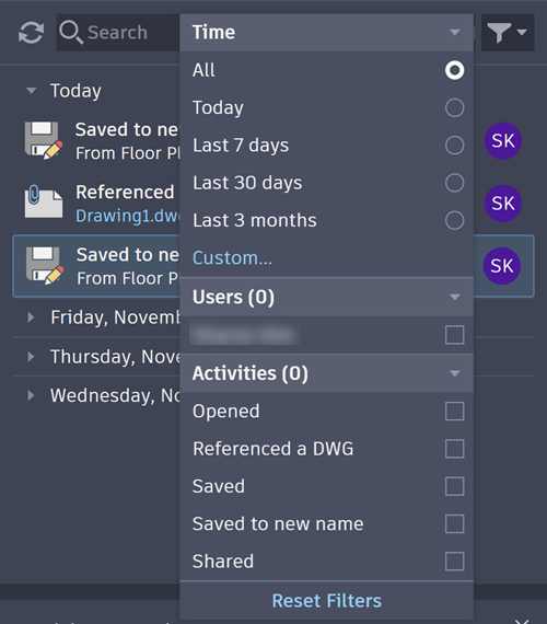

Search and Filter
We've simplified our search and filter bars for ease of use. Now, you can filter activities by time, users, and specific activities with one button.

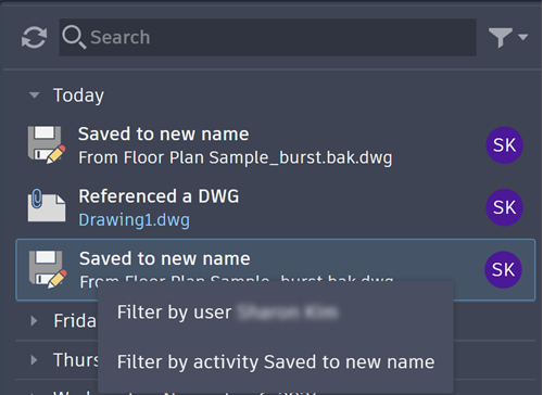

You can also access filters easily by right-clicking any activity. This action allows you to filter by the user who did the activity, or filter by the same type of activity.
