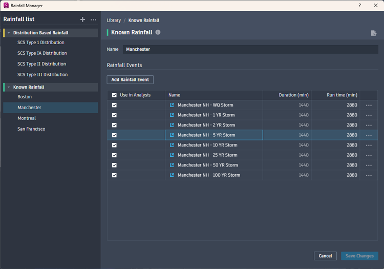

The Rainfall Manager provides a centralized location for creating, editing, and managing all rainfall data used in the software. This includes both pre-defined rainfall patterns and user-created custom events. Organize rainfall data into common sets, ensuring easy access and consistent application across different analyses.
The Rainfall Manager simplifies the process of working with rainfall information by facilitating the creation of new rainfall patterns, the modification of existing data patterns, and the deletion of unused data, to provide comprehensive control over all rainfall inputs.
The Rainfall Manager User Interface
The Rainfall Manager consists of two sections. The Rainfall List panel (left) and the Rainfall Creation workspace (right).
