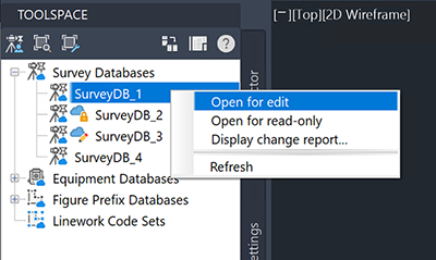

To review a cloud survey database lock status
When opening a survey database on
Autodesk Forma for editing, it may be locked. This status can be determined in the Survey Databases Collection.
- In Toolspace, on the Survey tab expand the Survey Databases collection.
- The locked database icon
will display next to any locked survey database. This status is shown to anyone connected to this database.
- Place your cursor over the icon to view the stakeholder who locked the database and the time/date stamp it was locked. You can still use the data in a read-only state. Right-click the survey database and select Open file read-only.
To open a cloud database for editing
- Right-click the database to be edited.
- Select Open for edit.
