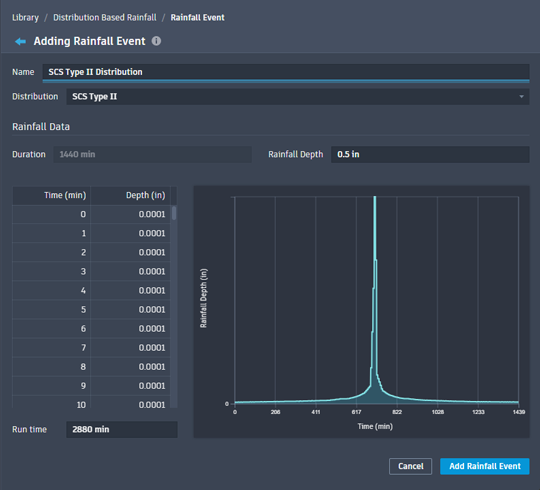

  1. In the Distribution Based Rainfall Creation workspace, click Add Rainfall Event to begin creating events for the rainfall set. The Adding Rainfall Event editor displays.
  2. In the Name field, enter a unique name for the rainfall event.
  3. Select a distribution type from the Distribution menu. There are 4 synthetic temporal pattern rainfall distribution curves available from the Soil Conservation Service (SCS): SCS Type I, SCS Type IA, SCS Type II, or SCS Type III.
  4. Enter a Rainfall Depth for the rainfall distribution Duration.
  5. (Optional) Adjust the Run time for the rainfall distribution. The default is twice its preconfigured Duration.
  6. The data is then presented in a table and a hyetograph.
    The table and hyetograph can display either Depth or Intensity data. Data displays using the units defined in the source drawing.
    Note: There must be at least 2 entries containing the minute increment and its coinciding rain depth in inches (or millimeters depending on drawing units).
  7. Click Add Rainfall Event to add the event to the Distribution Based Rainfall set. The Distribution Based Rainfall Creation editor displays showing the updated Rainfall Events List.
  8. Click Create Rainfall to save the Distribution Based Rainfall set. The Rainfall List displays the new rainfall set.
