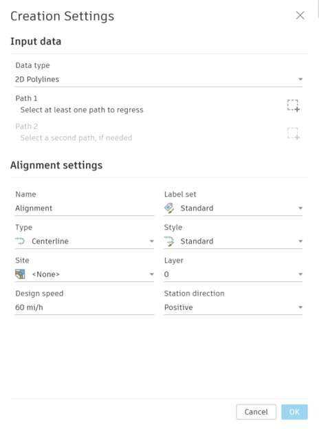

To generate an alignment through horizontal regression analysis, you first specify the surveyed linear data and then define the base alignment properties.
To specify the horizontal regression criteria
  1. Open the Horizontal Regression Set Up dialog box.
    • Click Home tab Create Design panel Alignment drop-down Horizontal Regression Analysis .
    • Click Rail tab Alignment panel Horizontal Regression Analysis .
  2. In the Horizontal Regression Setup dialog box, under Input Data, specify the type of data from which to create the horizontal regression analysis: either COGO Points, Feature Lines, 2D Polylines, or 3D Polylines.
  3. Next to Path 1, click .
    Note: If you selected COGO Points as the Input Type, you can use a drop-down list to select a point group.
  4. In the drawing, select the objects from which you want to create the horizontal regression analysis. Press Enter.
    Note: You may only select objects that are the input type you selected in Step 2. You may not select multiple types of objects.
  5. If you wish to create the horizontal regression analysis between two paths of objects, next to Path 2, click . This step is optional. If you choose to select a Path 2, the output of the regression will be the CENTERLINE between Path 1 and Path 2.
  6. In the drawing, select the objects from which you want to create the horizontal regression analysis. Press Enter.
  7. Under Alignment Settings, specify the following parameters:
    • Name
    • Site
    • Type
    • Style
    • Label Set
    • Layer
    • Design Speed
    Note: The alignment Name cannot contain the following unsupported characters: / \ " ; = , * ? ``. Alignment names can not be empty and they must be unique within the drawing.
