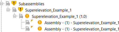

To update subassemblies in a drawing
When a subassembly PKT file that is referenced in a drawing is updated, symbols and tooltips are displayed on the items in the Prospector tree to alert you.
  1. In the Subassemblies collection in the Prospector tree, right-click the out of date subassembly item.
  2. Click Update All Subassemblies.

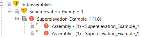

To update paths for subassemblies
When a path for a subassembly PKT file needs to be updated, symbols and tooltips are displayed on the items in the Prospector tree to alert you.
  1. In the Subassemblies collection in the Prospector tree, right-click the subassembly with the path that needs to be updated.
  2. Click Fix Missing Paths to display the Subassembly Source Paths dialog box where you can update the paths.
