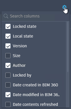

Select Columns
Opens a list for selecting which columns to view in the folder. The available columns are described in the following sections.
