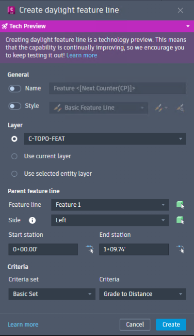

Automated Daylight Generation
Generate daylight feature lines directly from existing grading criteria. Created feature lines behave as standard feature lines, allowing full editing flexibility with familiar tools.
Flexible Command Options
Fine-tune your daylight feature line creation with comprehensive command options:
- Grading Criteria - Select from available criteria
Station Range - Define start and end stations
Side - Specify the side where the daylight feature line will be located
Layer - Assign to desired layer
- Name and Style - Apply custom naming and styling
