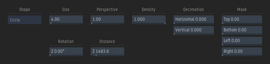

Atomize
The rendering results of the Atomize object have been improved to more closely match those in previous versions of the application. Additionally, parameters have been added to add flexibility to the definition of the look of points in the point cloud.
Shape option
Select whether to display the points as circles, crosses, stars, hexagons, horizontal lines, vertical lines, octagons, pentagons, squares, or triangles.
Note: For shapes with semi-transparent edges, enable Sort in the Rendering section of the parent object to achieve optimal rendering results.
Size field
Sets the size of a point.
Note: Depending on the Shape type, the Size may need to be increased, as more or fewer pixels are drawn.
Rotation field
Sets the rotation angle of the points.
Perspective field
Sets the amount of perspective applied to the size variation of the points.
Distance field
Sets the distance between the points and the rendering camera using the Perspective value.
Density field
Sets the density of points in the cloud. A value of 0.000 displays no points, while 1.000 displays all points.
Horizontal Decimation field
Sets the number of horizontal pixel lines to remove from the point.
Vertical Decimation field
Sets the number of vertical pixel lines to remove from the point.
Masking Top field
Sets the masking amount from the top edge.
Masking Bottom field
Sets the masking amount from the bottom edge.
Masking Left field
Sets the masking amount from the left edge.
Masking Right field
Sets the masking amount from the right edge.
