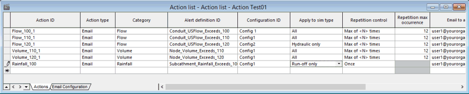

Actions tab
Used to define actions:
Alert Definition List grid
Action tab description
Field
Description
Action ID
Name of the action (must be unique).
Action type
Type of action to be carried out.
Currently Email is the only action type supported. An email is sent when the action is triggered.
Category
The action category that this action belongs to.
If a category is specified, all actions with the same category will be grouped together into one email.
If no category is specified, this action will be sent in a single email when this action is triggered.
Alert definition ID Alert definition ID of Alert that will act as the action trigger.
Configuration ID The ID of the email configuration as defined in the Email Configuration tab.
Apply to sim type
The type of simulation to which the action is to apply. Choices are:
  • All - apply action to both observed and full runs
  • Run-off only - apply action to observed runs only
  • Hydraulic only - apply action to full runs only
Repetition control
Determines the repetition of the action. Choices are:
  • Null - repeat action regardless of number of times action trigger has occurred
  • Once - only carry out action once if the alert triggering the action occurs in consecutive simulations; i.e. do not repeat action if action trigger also occurred in the simulation immediately previous to the current simulation
  • Max of <N> times - carry out action if the alert triggering the action occurs in consecutive simulations up to <N> times. Do not repeat action if number of consecutive sims alert occurs in exceeds <N>.
Repetition max occurrence
Enabled when Repetition control is set to Max of <N> times.
The maximum number of times an action will be carried out in consecutive sims. When this number is reached, the action will be stopped, even if the alert continues to occur.
When a simulation is run in which the alert triggering the action does not occur, actions will resume the next time the alert occurs.
