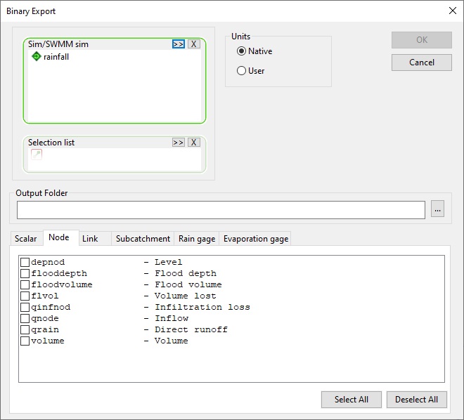

Binary Export Dialog
This dialog is used to export results from one or more simulations for a selection of network objects to a binary (DAT) file.
It is displayed when Export to binary files is selected from the Results menu.
Option
Description
Sim/SWMM sim
A droptarget for the simulations whose results are to be exported.
Note: If you have selected any cloud simulations whose full results have not been downloaded, a message is displayed informing you of this and asks if you would like to download the results now. Selecting Yes will download the results, which can then be added to this box.
Selection List
A droptarget for a Selection list, which can be used to restrict export of results to a selection of network objects. If a selection list is not included, the results of all network objects are exported.
Units
Determines whether the results are exported in the current User units or in InfoWorks ICM Native (metric) units.
Output Folder
The path of the folder to which the results are to be exported. This can be typed-in or browsed for using the button.
Attribute option tabs
The lower half of the dialog contains tabs for each type of network object for which results can be exported. The attributes to be exported are selected by checking the appropriate boxes on the tabs..
Using the Select All and Deselect All buttons checks or unchecks all attributes on the current option tab.
For further information about how to export results to binary files, see the Exporting Results to Files topic.
