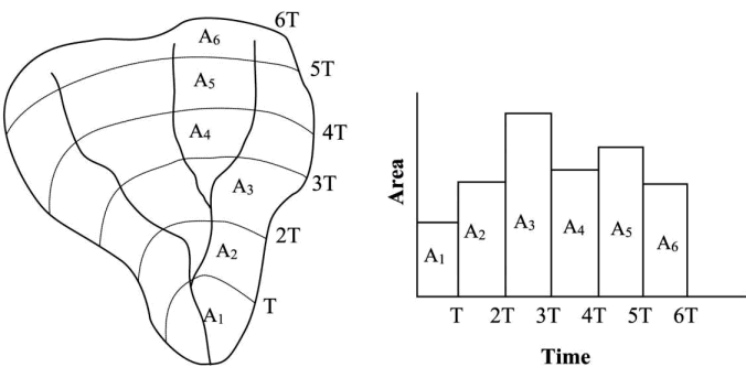

Clark (1945)[1] noted that the translation of flow through the watershed could be described by a time-area curve (see Figure 1), which expresses the curve of the fraction of watershed area contributing runoff to the watershed outlet as a function of travel time since the start of effective precipitation. Each sub-area is delineated so that all the precipitation falling on the sub-area instantaneously has the same time of travel to the outflow point. Developing a time-area curve for a watershed could be a time consuming process. For watersheds that lack derived time-area diagram, the HEC-HMS model[2], which was developed at the Hydrologic Engineering Center (HEC) of the U.S. Army Corps of Engineers, uses the following relationship (HEC, 2000):

If the incremental areas, denoted as Ai in Figure 1, are multiplied by a unit depth of excess rainfall and divided by Δt, the computational time step, the result is a translated hydrograph that is considered as an inflow to a conceptual linear reservoir located at the watershed outlet.
Figure 1
