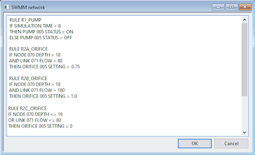

This editor is used to view and edit the control rules for specified
ancillary regulator structures, such as pumps and weirs in a
SWMM network, and is displayed by selecting Grid windows
SWMM control rules editor from the Window menu.
The editor consists of the following items:
The format used to specify the control rules is described in the Control Rules Format topic.

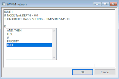

A context menu allows you to perform editing tasks such as copy and paste, and an auto-suggestion feature analyses the text as you type, compares it to the format rules and provides suggestions for keywords, types of objects, attributes or types of values in a popup list.
A red squiggly line is displayed under an invalid item. Click on the squiggly line to display the popup list (if not already displayed) of valid suggestions for that item. Double- click on a suggested item to insert it into the rule.
