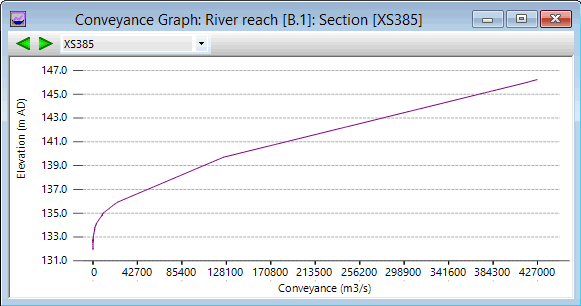

The window is displayed when you click Conveyance Graph (Conveyance graph pick) on the More GeoPlan Tools Toolbar and a river reach or bridge section is subsequently selected on the GeoPlan.
Example of a Conveyance Graph Window for a selected river reach section
The window initially displays the conveyance curve for the selected section, and you can use the window options to display additional curves. See Conveyance Graph Window options (below).
For river reach sections, up to 9 additional conveyance curves can be displayed for neighbouring sections, located up or downstream of the selected section.

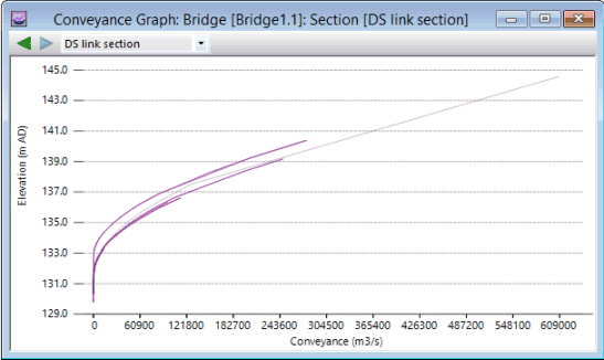

For bridge sections, the conveyance curves can be displayed for the upstream link, upstream bridge, bridge deck (contraction), bridge deck (expansion), downstream bridge and downstream link sections. Note that the sections for the Bridge deck (contraction) and Bridge deck (expansion) sections are obtained by combining the bridge deck section with the upstream and downstream bridge sections respectively.
Example of Conveyance Graph Window showing all conveyance curves for a bridge section
