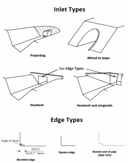

The equations governing inlet losses include several empirical variables. The values for which can be automatically set by the software if the #D flag is set on the applicable properties. These values are derived from the Hydraulic Design of Highway Culverts publication (and earlier research), and depend on the selected Culvert code (shape and material, and inlet and edge type, see figure below). See Culvert Inlet Data Fields for further information.
Inlet Types
Typical values for the various inlet control parameters can be found in the FHWA guide.
