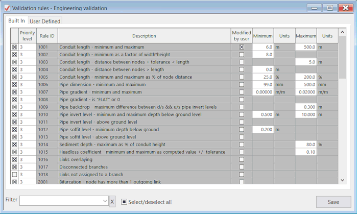

This dialog is displayed by double-clicking on an engineering validation item in the Explorer window or right-clicking on the object and selecting Open.
This dialog consists of two tabs, Built In and User Defined, which are described in the following sections, as well as the following items:
A filter can be removed by deleting its name from the Filter field using the
button.
The built in validation rules, displayed on the Built In tab, cannot be added, but existing rules can be switched on and off, and threshold values used by the rules can be changed. In some cases, a tolerance value can be entered (for example, when comparing conduit length with distance between nodes). The tolerance value is added to or subtracted from the field value before the comparison is made. This tolerance value is entered in the Maximum or Minimum column respectively.
See the Engineering Validation topic for more details on individual built in rules.
The Engineering Validation grid contains the following columns:
Check rule |
A check box that determines whether or not the rule is included in the validation. A check in the box indicates that the rule will be included. If unchecked, the rule is excluded. |
Priority level |
The priority level assigned to the rule is shown in the Output Window. By default, engineering validation rules are given a priority of 3. For serious errors or warnings, set the Priority level to 1 or 2 respectively. |
Rule ID |
A unique identifier for the rule, set by the system. An 'I' prefix is added to the Rule ID when it is displayed in the Code column of the Output Window. |
Description |
A description of the validation rule, set by the system and used as the basis for the Output Window message. |
Modified by user |
This box is set by the system when the validation rule is modified. |
Minimum |
The minimum value against which the data is checked. This box is greyed out when no minimum value is required for the rule. |
Units |
The units used for the minimum value. |
Maximum |
The maximum value against which the data is checked. This box is greyed out when no maximum value is required for the rule. |
Units |
The units used for the maximum value. |
