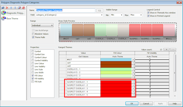

If the Apply Theme checkbox has been left ticked on the Create Diagnostic Polygons Dialog, diagnostic polygons are assigned by default a theme based on their category.
The user is informed that a new theme has been generated for diagnostic polygons. The new theme is available for the Polygon object layer and can be edited like any other theme via the Layers and Themes page of the GeoPlan Properties dialog.
It is recommended to click Yes on the message that gets displayed following diagnostic polygon generation in order to save this theme as a database object. This theme gets deleted from the Polygon themes whenever diagnostic polygons are deleted so it is a good idea to have a copy of it saved in the Database tree.
Suspect polygons are highlighted in bright red. Other overlay polygons get assigned other colours, as shown below. The original polygons are assigned the same colours by default. (In the screenshot below, cat1 and cat2, which are the categories of the original polygons, have got both the same colour).

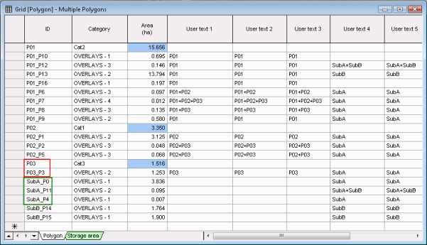

Newly created polygons are given IDs that are the combination of the original objects they derive from (prefix), and of a suffix of the type '_PX' where P stands for polygon and X is an integer.
In the screenshot below, for example, P03_P3 polygon is the only polygon derived from original polygon P03. On the other hand, Subcatchment SubA, when intersected, resulted in the generation of 3 different polygons: SubA_P0, SubA_P11 and SubcA_P4.

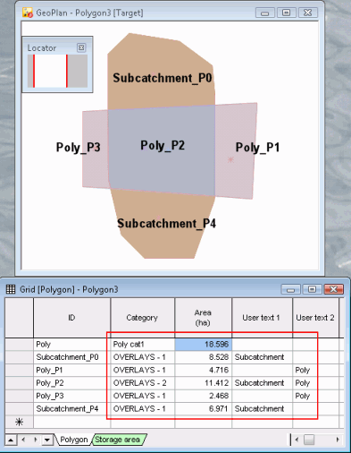

Newly created polygons are also given a category indicating the level of overlay. The category assigned to a polygon depends on the order objects have been selected in the Create Diagnostic Polygons dialog. User text field 1, 2, 3, 4 and 5 are used to mark the newly created polygons with the ID of objects they originate from.
If the objects to be intersected are all of the same type (e.g. subcatchments only or polygons only), the IDs of the objects a polygon originates from will be appended in the same user text field. On the other hand, if objects of different type are being intersected (e.g. subcatchments and polygons), then different user text fields will be used.

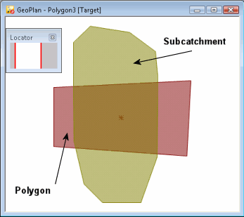

The method of carrying out the generation of Diagnostic Polygons and the results produced are best demonstrated as examples:
| ID | Cateogry | |
Subcatchment |
SubcB |
Polygon |
Poly A |
Poly Cat1 |
Show me
Create diagnostic polygons from the Model menu. This displays the
Create Diagnostic Polygons Dialog.

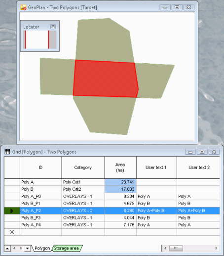

This case is very similar to the previous example, except that we are now interested in objects of the same type (a polygon overlapping another polygon).
| ID | Category | |
Polygon A |
Poly A |
Poly Cat1 |
Polygon B |
Poly B |
Poly Cat2 |
As can be seen from the screenshot below, the polygon resulting from the overlap between the two original polygons has been assigned the two IDs of the polygons it originates from and these are appended in the user-text fields (Poly A + Poly B).

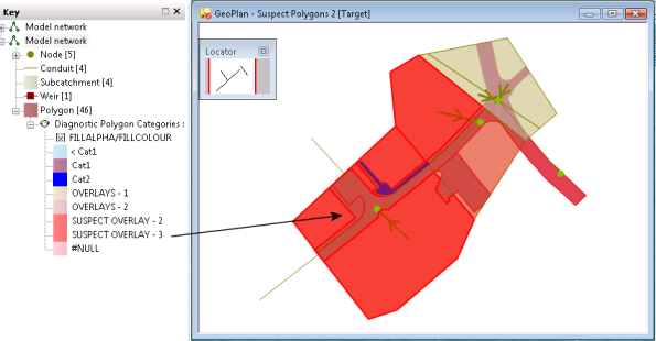

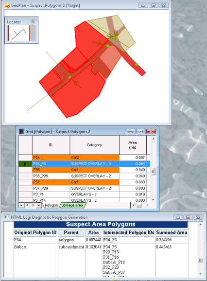

This section shows the example of an intersection that has resulted in the generation of a suspect polygon. As the Apply Theme checkbox of the Create Diagnostic Polygons dialog has been left ticked, a polygon theme is applied by default to the newly created polygons.
Suspect polygons are highlighted in red.
Show me
A closer investigation of the Polygons grid and the log file allows us to understand why some polygons have been marked as suspect.
Newly created polygon P34_P3 (suspect polygon in red in the screenshot above) is the only polygon originating from polygon P34 (coloured in blue / purple for the purpose of this example). Area of P34_P3 is 0.354 ha whereas area of P34 is 0.007. The surface difference being out by more than 10% of the original surface, the newly created polygon is considered as suspicious. This indicates that the user should simplify the geometry of polygon P34.

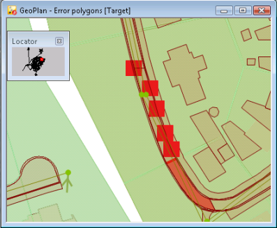

This example shows a network on which a series of error polygons have been generated. This points the user to the areas to investigate.
If you cannot easily see the error polygons on a too dense a network , you can use a combination of the log file (you can identify the original polygon IDs there) and the GeoPlan search tools to locate them on the network. Alternatively, you can modify the Diagnostic Polygon theme or any other GeoPlan theme to make the error polygons more visible or prominent in the GeoPlan. Please refer to the Managing Themes topic for further details.

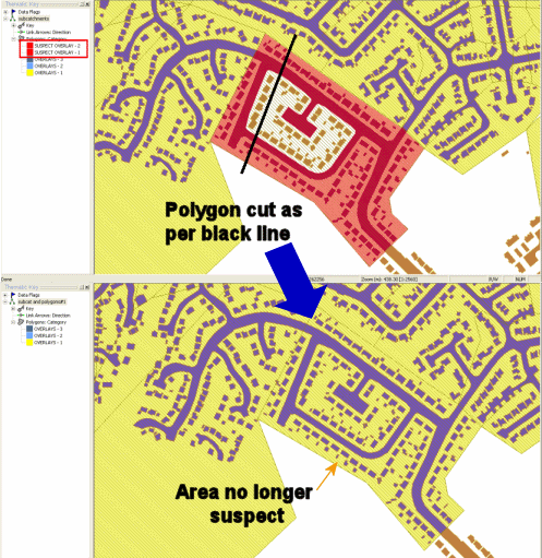

If a suspect polygon is generated and within this polygon, there is an area with no polygons, you should cut the surrounding shape.
