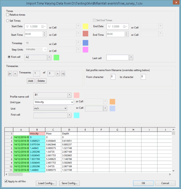

Importing from Generic CSV Files
Data can either be imported to a new event in a Flow Survey or appended to an existing event in a Flow Survey.
To import flow survey data from a file in general CSV format
- Right click on a Flow Survey (to create a new event) or Flow Survey Event (to append data to an existing event) in the
Explorer Window and select Import
rom generic CSV file from the popup menu. A standard Windows Open Dialog will be displayed.
- Select the files to be imported (multiple files may be selected) and click on Open. The
Import Time Varying Data from CSV Dialog will be displayed.
- Set the import parameters on the import dialog. Values can be entered directly or read from the file to be imported. To read a value from the file: click on a cell in the grid at the bottom of the dialog and then on the * button.
- If you are importing multiple CSV files, then check the Apply to all files box to apply the current settings to all the files being imported. If the option is unchecked, the
Import Time Varying Data from CSV dialog will be displayed before the import of each selected file.
- Click OK to complete the import. A profile will be created for each data series imported.
The settings for commonly used file types can be saved. Set up import parameters on the dialog, and then use the Save Config button to save them to a file. The Load Config button can then be used to open an existing configuration.
