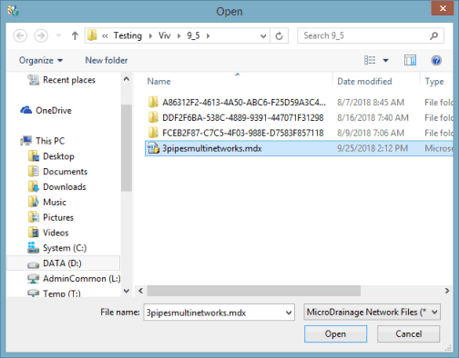

To import MicroDrainage network data
Model
from MicroDrainage data from the Network menu, and a standard Windows
Open dialog is displayed.

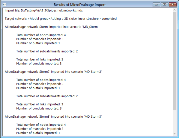

An import report will be displayed with any import errors or warnings. It will also include the full path of the mdx file which was imported together with the full path in the InfoWorks ICM tree of the target network.
For an mdx file with a single MicroDrainage network, all data is imported into the currently selected scenario of the target network in InfoWorks ICM.
For an mdx file with multiple MicroDrainage networks, the data from each MicroDrainage network is imported into a different scenario in the target network. For example, a MicroDrainage network with name "XXXXX" the corresponding scenario in InfoWorks ICM is named "MD_XXXXX". If a scenario does not already exist, a new one will be created.
For each scenario the report provides the total number of imported objects of different types.
For details of the objects imported and any conversions made by the MicroDrainage Importer, see the Import Notes below.
