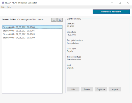

Main page
This page is initially displayed when the NOAA ATLAS 14 Rainfall Generator button is selected from the Rainfall Generator dialog.
The items contained in the main page of the dialog are described in the following table:
Item Description
Generate a new storm Opens the Rainfall data page, allowing you to specify the required parameters for the NOAA storm to be generated.
Current folder
Displays the name of the current folder.
A list of NOAA storm zip files, located in the Current folder, are displayed in the list box.
When a new storm is saved, the downloaded zip file is automatically saved to the currently selected folder.
Browse
Opens a Browser for folder window that allows you to select another folder or create a new one. The name of the new or selected folder will be displayed in the Current folder.
Reload
Reloads the existing NOAA storm zip files that are located in the Current folder and displays their names in the list box.
Event Summary
Displays the following event summary data for the storm that is currently selected in the Current folder list box:
  • Latitude
  • Longitude
  • Precipitation type
  • Data type
  • Timeseries type
  • Unit
See the Rainfall data page for further information.
Edit
Opens the Rainfall data page for the storm currently selected in the Current folder list box.
Delete
Deletes the file currently selected in the Current folder list box.
Duplicate
Creates a duplicate zip file for the storm currently selected in the Current folder list box. The duplicated file will have a ! appended to its name.
Import
Unzips the applicable storm files for the storm currently selected in the Current folder list box, and imports the applicable rainfall data for each storm to the Storm grid in the NOAA Rainfall Generator dialog.

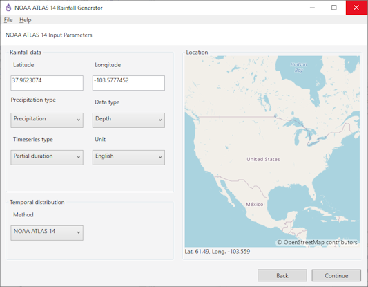

Rainfall data page
This page is displayed when you either click Generate a new storm or select the New option from the File menu in the Main page, and is used to specify the rainfall parameters for the storm.
The items contained in the Rainfall data page are described in the following table:
Item Description
Latitude
The latitude of a location for which storm data is to be downloaded.
This can either be typed in or selected on the map displayed in the Location box.
The specified Latitude and Longitude denote the centroid location for the storm data to be generated.
Longitude The longitude of a location for which storm data is to be downloaded.
The specified Latitude and Longitude denote the centroid location for the storm to be generated.
Precipitation type The type of precipitation data (precipitation, i.e. all types or rainfall only) to be included in the generated storm.
Data type The type of storm data (depth or intensity) to be included in the generated storm.
Timeseries type The type of time series data (annual maximum or partial duration) to be included in the generated storm.
Unit The type units (English or metric) to be used for the generated storm data.
Method
The method for temporal distribution to be used for the generated storm data. Choose one of the following methods:
  • NOAA ATLAS 14
  • NRCS Regional
  • Huff Distribution
  • Bulletin 75
  • Alternating Block
Location
The location for which storm data is to be downloaded can be selected by clicking on a position on the displayed map. If a location is selected on the map, its latitude is displayed in the Latitude field and its longitude in the Longitude field.
Tip: The mouse scroll button can be used to zoom in or out on the map.
Back Discards any changes and returns to the Main page.
Continue Saves any changes, downloads the relevant data and displays the Temporal distribution page.

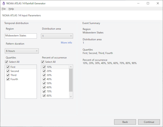

This page is displayed when you click Continue on the Rainfall data page, and have selected NOAA ATLAS 14, NRCS Regional, Huff Distribution or Bulletin 75 as the method of distribution. It is used to specify the temporal distribution parameters for the storm.
The items contained in the Temporal distribution page are described in the following table:
Item Description
Region
If the Method for temporal distribution is set to NRCS Regional on the Rainfall data page, this is a dropdown list of temporal distribution regions from which the applicable one can be selected.
If the Method for temporal distribution is set to NOAA ATLAS 14, this is a read-only field which displays the name of the region within which the specified Latitude and Longitude are located.
Pattern duration
Displayed when the Method for temporal distribution is set to NOAA ATLAS 14 on the Rainfall data page.
A dropdown of the durations for the temporal distribution.
Catchment area
Displayed when the Method for temporal distribution is set to Huff Distribution or Bulletin 75 on the Rainfall data page.
A dropdown of the size of the catchment area for which storm data is to be generated.
Distribution area
A dropdown of the distribution area within the Region for which storm data is to be generated.
Distribution type
Displayed when the Method for temporal distribution is set to NRCS Regional on the Rainfall data page.
A dropdown of the distribution types within the selected Region which are to be used for generating the storm data.
Quartile
A list of distribution quartiles. A check in a box indicates that data for that quartile is to be included in the storm data. Removing a check will exclude that quartile data from the storm.
By default, the Select all box is checked and all quartiles are selected. De-selecting the Select all box removes the check from any quartile currently selected.
Note: At least one quartile must be checked.
Percent of occurrence
A list of occurrence percentages. A check in the box indicates that data for that percent of occurrence is to be included in the storm data. Removing a check will exclude any data for that occurrence from the storm.
By default, the Select all box is checked and all occurrence percentages are selected. De-selecting the Select all box removes the check from any occurrence percentages currently selected.
Note: At least one percent of occurrence must be checked.
More info
A hyperlink that opens the Temporal Distributions page on the Hydrometeorological Design Studies Center website, where you can find further information about temporal distribution.
Event Summary
Displays the following event summary data for the storm that is currently defined on this page.
If the Method for temporal distribution is set to NOAA ATLAS 14 on the Rainfall data page, the following summary information is displayed:
  • Region
  • Distribution area
  • Quartile
  • Percent of occurrence
If the Method for temporal distribution is set to NRCS Regional on the Rainfall data page, the following summary information will be displayed:
  • Region
  • Distribution type
If the Method for temporal distribution is set to Huff Distribution or Bulletin 75 on the Rainfall data page, the following summary information will be displayed:
  • Catchment area
See the descriptions above for further information.
Back Discards any changes and returns to the Rainfall data page.
Continue Saves any changes, downloads the relevant data and displays the Event page.

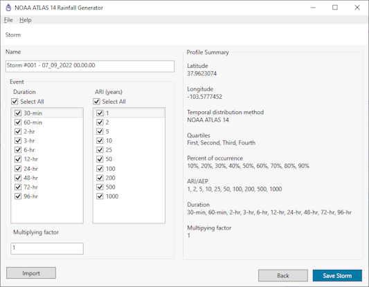

Event page
This page is displayed when you click Continue on the Temporal distribution page and is used to specify the name and event parameters for the storm. Or, if you have selected Alternating Block as the method of distribution, then this page is displayed when you click Continue on the Rainfall data page, and is used to specify the temporal distribution parameters for the storm.
This page is also used to save and import the relevant storm data.
Show me
The items contained in the Event page are described in the following table:
Item Description
Name
A unique name for the storm. The downloaded data is saved to a zip file with the name specified in this field.
A name is automatically generated using the format:Storm #000 - <date>You can change this name but you cannot use a name that is already used for another storm file located in the current folder.
Time series interval
Displayed when the Method for temporal distribution is set to Alternating Block on the Rainfall data page.
The time series interval must be an integer that is divisible by 5. No decimals are allowed.
Time to peak
The time to peak can be selected from the dropdown. The default is 50%.
Duration
A list of storm durations in minutes, hours and days. A check in the box indicates that data for that duration is to be included in the storm data. Removing a check will exclude that duration from the storm.
By default, the Select all box is checked and all durations are selected. De-selecting the Select all box removes the checks from any durations currently selected.
Note: At least one duration must be checked.
ARI
Displayed when Timeseries type is set to Partial duration on the on the Rainfall data page.
A list of annual recurrence intervals (ARI) in years. A check in the box indicates that data for that ARI is to be included in the generated storm data. Removing a check will exclude that ARI from the storm.
By default, the Select all box is checked and all ARIs are selected. De-selecting the Select all box removes the checks from any ARIs currently selected.
Note: At least one ARI must be checked.
AEP
Displayed when Timeseries type is set to Annual maximum on the Rainfall data page.
A list of annual exceedance probabilities (AEP) in years. A check in the box indicates that data for that AEP is to be included in the generated storm data. Removing a check will exclude that AEP from the storm.
By default, the Select all box is checked and all AEPs are selected. De-selecting the Select all box removes the checks from any AEPs currently selected.
Note: At least one AEP must be checked.
Multiplying factor
A multiplying factor that allows scenarios, such as a 10% increase in rainfall, to be investigated.
Profile Summary
Displays the following profile summary:
  • Latitude - See the Rainfall data page for further information
  • Longitude - See the Rainfall data page for further information
  • Temporal distribution method. See the Rainfall data page for further information
  • ARI/AEP - See the descriptions above for further information
  • Duration - See the description above for further information
  • Multiplying factor - See the description above for further information
If the Method for temporal distribution is set to NOAA ATLAS 14 on the Rainfall data page, the following information will also be included in the profile summary:
  • Quartiles - See the Temporal distribution page for further information
  • Percent of occurrence - See the Temporal distribution page for further information
If the Method for temporal distribution is set to NRCS Regional on the Rainfall data page, the following information will also be included in the profile summary:
  • Distribution type - See the Temporal distribution page for further information
If the Method for temporal distribution is set to Huff Distribution or Bulletin 75 on the Rainfall data page, the following information will also be included in the profile summary:
  • Catchment area - See the Temporal distribution page for further information
If the Method for temporal distribution is set to Alternating Block on the Rainfall data page, the following information will also be included in the profile summary:
  • Time series interval - See the description above for further information
  • Time to peak - See the description above for further information
Back Discards any changes and returns to the Temporal distribution page.
Save storm Saves the downloaded storm data to a zip file with the name specified in the Name field and displays the Main page. The file is automatically stored to the folder currently selected on the Main page, and the name of the storm will added to the Current folder list on the Main page.
Import storm
Closes the NOAA Atlas 14 Rainfall Generator, unzips the downloaded file for this storm, and imports the relevant data for each storm to the Storm grid in the Rainfall Generator dialog.
A file will not be saved to the folder currently selected on the Main page.
See Generating NOAA Rainfall for information about how to use the NOAA ATLAS 14 rainfall generator to generate data for a NOAA design rainfall event.
