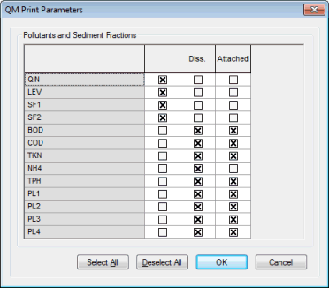

Results Export Filter Dialog
This dialog allows you to choose what file types to save when exporting results to files, and is displayed when you click any of the Filter buttons on the Export Results Data dialog.
The ability to choose what results to export is particularly useful in water quality simulations, where there can be many different files, containing results for individual determinants and sediment fractions.
