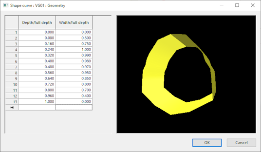

The Shape Curve Editor is displayed when the
button is selected in the Geometry field in a
Shape curve, and is used to specify the height and width values which define the cross section of a custom shape type of
conduit. These are both normalised with respect to full depth. A 3D view of the cross section shape is shown in the editor as the relationships are entered.
An example is shown below.
| Item | Description |
| Grid / 3d view |
The depth and width values specified in the grid will appear in the 3D view. Note that the X values must be specified in increasing order. The view represents how the width of the cross-section varies with height, where both width and height are scaled relative to the section's full depth. See the Shape Curve Data Fields (SWMM) for further information. |
| OK | Saves any changes to the values in the grid and closes the editor. |
| Cancel | Discards any changes to the grid values and closes the editor. |
See Creating User-defined Shapes (SWMM) for information about using the editor to create shape curves.
