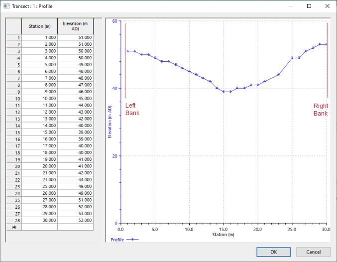

For each 'point' on the cross-section, a station (the distance from the left bank) and a corresponding elevation must be specified which are used to generate the cross-section channel profile. An example is shown below:
Transect Profile
