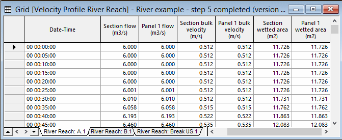

The Velocity Profile Report provides a detailed breakdown of flow, bulk velocity and wetted area for a selection of river reaches. Values are provided at each timestep for each river reach section as a whole and for individual panels that make up the sections.
See Grid Reports for information on creating a velocity profile report.
Velocity profile data for each selected simulation is displayed in a separate grid window which can have either a single tab or a tab for each river reach or river reach section.

| Section flow | Flow for whole section |
| Panel N flow | Flow for panel number N of section |
| Section bulk velocity | Velocity for whole section |
| Panel N bulk velocity | Velocity for panel number N of section |
| Section wetted area | Wetted area for whole section calculated as Section flow / Section bulk velocity |
| Panel N wetted area | Wetted area for panel number N of section |
