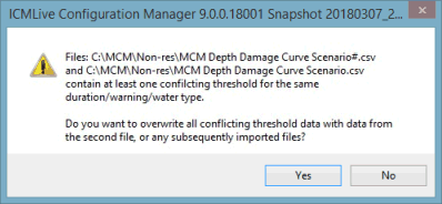

    • The values in the selected duration csv files are not being imported into existing thresholds with the same values in the Damage Function. If they are, a message, similar to the one below, may be displayed:
      Invalid Message - Threshold
      Select No to keep the existing threshold data or Yes to import the threshold data from the file currently being imported. If Yes is selected, any duplicate threshold data will be automatically overwritten by data in any files subsequently imported. Note that if, for example, 3 duration files are being imported into a Damage Function that currently contains no threshold data, then the first file will be imported. When the second file is being imported, InfoWorks ICM will check if it contains any threshold information whose values are the same as in the first imported file, and if it does, a message similar to the previous one will be displayed.
