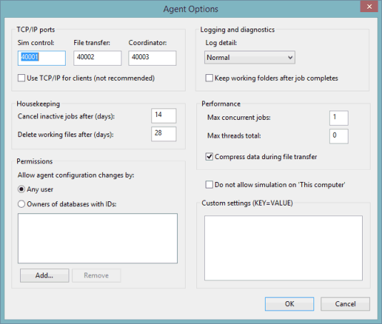

Agent Options Dialog
This dialog is displayed when the Agent option button is selected in the Manage Job Agents dialog. It is used to set various options, including housekeeping, permissions, performance and logging details, for the agent or agent coordinator currently selected in the Connected job agents list on the Manage Job Agents dialog.

The items which comprise the Agent Options dialog are described below.
Item
Description
TCP/IP ports
The TCP/IP port settings are set as default and would not normally need to be changed unless, for example, there is conflict with another networked application.
Note that these ports must be open for all computers in a workgoup environment.
Note: Changing these default settings could cause the entire workgroup to stop working.
Port numbers from 1 to 65535 can be assigned to any of the TCP/IP ports, however, numbers 1 to 1024 are reserved and therefore should be avoided.
In addition, the port numbers assigned to the Sim control, File transfer and Coordinator ports must be unique.
Note: When OK button is clicked, error messages will be displayed if a specified port number is outside the valid range or a duplicate port number is used.
Use TCP/IP for clients (not recommended)
A check box which indicates whether or not TCP/IP should be used for clients. Unchecked (not used) by default.
TCP/IP for clients is not recommended because it means the local agent might not then be able to access mapped drives and network shares that the user has permission to access. When connecting using a local pipe (the default option) the local agent can 'impersonate' the user to access these resources, which might be needed to, for example, access GIS data files for a meshing job.
The only scenario for which TCP/IP is recommended is when running clients on a cluster of machines (e.g. a Citrix farm) and a user who disconnects and reconnects may find themselves using a client on a different machine. In this scenario, all clients could connect via TCP/IP to a single 'local' agent running on a separate server and so see the same job queue regardless of the machine their client is running on.
Cancel inactive jobs after (days)
A housekeeping function which allows you to specify the number of days which must elapse before an inactive job is cancelled from this agent.
Delete working files after (days) A housekeeping function which allows you to specify the number of days which must elapse before the working files are deleted. Setting this appropriately will prevent large numbers of files from being stored in the agent working folder.
Allow agent configuration changes by
A permissions function which allows you to choose who can save any modifications to the agent configuration. Select:
  • Any user (default) - to allow any InfoWorks ICM user to save the changes the agent configuration.
  • Owners of databases with IDs - to only allow the owner(s) of the databases, whose database GUIDs are listed in the box, to save any changes to the agent configuration. Databases are added and removed from the list using the Add and Remove buttons.
Add
Enables a database to be added to the Allow agent configuration changes list, allowing the owner(s) of that database to be able to save changes to the agent.
An Add database dialog is displayed when the button is selected. As default, the ID of the current database is displayed, which can be changed if required.
Remove Removes the database selected in the Allow agent configuration changes list from the list. Owners of the selected database will no longer be able to save changes to the agent.
Log detail
Sets how detailed the log files, which are generated by the agent and can be used for troubleshooting purposes, are to be. The options are:
  • Basic - the log file will contain only basic information such as agent start and stop details. You may want to use this option if the 'normal' log files are becoming too large.
  • Normal (default )- in addition to the basic details, this log file will also contain errors and summary information.
  • Trace - the log file will contain only job and file transfer details. You would only usually use this option for short periods of time when advised to do so by Innovyze support staff.
Note: Log file generation is only available if enabled via the InfoWorks Agent Manager Service Options.
Keep working folders after job completes
This option is unchecked by default. If checked, it will cause the disks to become full if running large numbers of simulations.
Note: This option should only be checked at the request of the Innovyze Support Team as it is ONLY used by Innovyze for debugging purposes.
Max concurrent jobs
The maximum number of simulation jobs that can be run at the same time on this agent. Default is 1. This is recommended even on multi-core or multi-processor machines, as the simulation engine is itself multi-threaded and hence runs fastest when all cores are available to it.
Max threads total
The maximum total number of threads to be used by all active simulation and mesh jobs running on this agent. If set to 0 (default), the actual limit is set to the number of cores on the computer.
The total thread limit is shared equally amongst active jobs. Each active job is allocated at least one thread (even if this takes the total threads above the limit). Per-job limits (specified on the Schedule Job(s) Dialog) are not exceeded.
A priority job (started using the Run immediately button in the Job Control Window) is allocated the total number of threads and runs at a higher priority than the already active jobs, each of which is allocated a single thread.
Compress data during file transfer This controls whether or not files should be compressed before transferring between remote agents and / or the coordinator agent. For efficient interoperability this option should always be checked (default).
Do not allow simulation on 'This computer' Check this box to ensure that a computer running the agent does also not run simulations, such as in a CITRIX environment. Unchecked by default.
Custom settings (KEY=VALUE) Additional options that may be applied to the agent. These are rarely required and should normally only be applied on the advice of the Autodesk Support Team. Descriptions of customs settings that you may be advised to use are described in the Custom settings section below.
