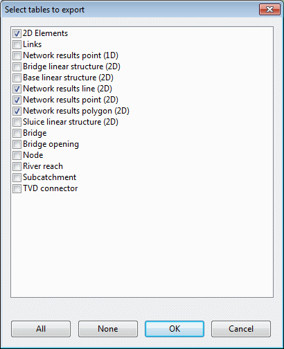

| Select tables |
If checked, export is restricted to a selection of tables. The tables to be exported can be selected when you click Tables. This displays the Select tables to export dialog.
Check the boxes next to the tables to be exported. Use the All and None buttons to select or deselect all tables in the list. |
