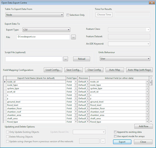

Open Data Export Centre Dialog
This dialog is used when exporting data to external data sources via the Open Data Export Centre.
It is displayed when you:
The Open Data Export Centre allows you to export data from InfoWorks ICM in a variety of formats. These are:

Units Behaviour
Select from User Units to export values using the current display units, or InfoWorks ICM Units to export values as InfoWorks ICM native units.
Field Mapping Configuration buttons
Use the Field Mapping Configuration buttons to apply saved mappings to the Field Mapping Grid:

Field Mapping Grid
The field mapping grid allows the mappings for individual data fields to be set up.
The grid contains a variable number of columns. Some columns only appear for some data types, and some columns will be disabled depending on the values of other columns.
See the Field Mapping Grid section below for further details.

Export
Validates the field mapping grid and then does one of the following:
  • exports the data if there were no errors or warnings

The geometry type (e.g. point, polyline, polygon) of the object being exported.
Applicable to Geodatabase and File Geodatabase only.
Data Type
The data type column allows you to override the normal export data type for this data field.
This column is hidden for comma and tab separated variable files. Data is always exported to these file types as text.
The possible data types are:
  • Boolean
  • Date
  • Text - up to 100 characters
  • Memo - text type field normally used for strings longer that 100 characters. Can hold about 10,000 words
  • Short - 2 byte integer
  • Long - 4 byte integer
  • Single - 4 byte floating point
  • Double - 8 byte floating point
  • GUID
By default, fields are exported in the same format as they are held in InfoWorks ICM. These formats are predominantly Text and Double.
You can choose to export any field in any format. If you try to export a string that cannot be represented as a number in one of the number formats, you will get a warning message after the export. You will get a warning message for every failure, so if you have a long list of objects it could be a long list.
It may be perfectly legitimate for you to export text fields as numbers. For example, if:
  • your node IDs are all numeric
  • you have stored numbers in the user text fields
If you export a text or numeric field as a Boolean value, the Boolean value will be set to true if:
  • a string field is not zero length
  • a numeric field has a value and the value is not zero
Otherwise, the Boolean will be set to false.
Length
Applicable to fields of Data Type Text only.
The default length for text fields is the maximum length of the field in InfoWorks ICM. If you are exporting something using SQL or Ruby Script into a text field, InfoWorks ICM scans the exported text, and sets the length of the longest string as the default.
If you choose a length for a text field and try to export strings that are longer than this maximum, the exported text will be truncated and you will receive a warning for each occurrence.
Precision
There are two reasons for changing the default precision:
  • InfoWorks ICM may store a value at a higher precision than you want to export.
  • If you are calculating the value with a Script or SQL, InfoWorks ICM cannot calculate a sensible precision for the value. It is up to you to set an appropriate precision.
Internal Field (or other data)
The entry in the Internal Field column will vary depending on the value selected in the Field Type column.
Field Type
Description
Fields
The dropdown list contains all the available fields. These fields include:
  • fields for the selected object type
  • fields for any object that can be "joined" to the selected object type
For example, joined fields may include:
  • the upstream and downstream nodes for a link
  • simulation results if results are loaded
  • simulation results at a joined object such as upstream and downstream nodes of a link
You are also allowed to export fields from arrays. This is the tabular data that can only be viewed in grids on an objects property sheet.
SQL
Enter an SQL expression
Constant
Enter a constant value
Special
Choose from the available set of special values:
  • simulation time if you are exporting results
  • the table name for the object being exported - the internal version of the name
  • the table description - a user friendly version of the table name
Script
Choose one of the available functions in the loaded script file
Geometry
Field is disabled. The geometry type of the object will be exported.
