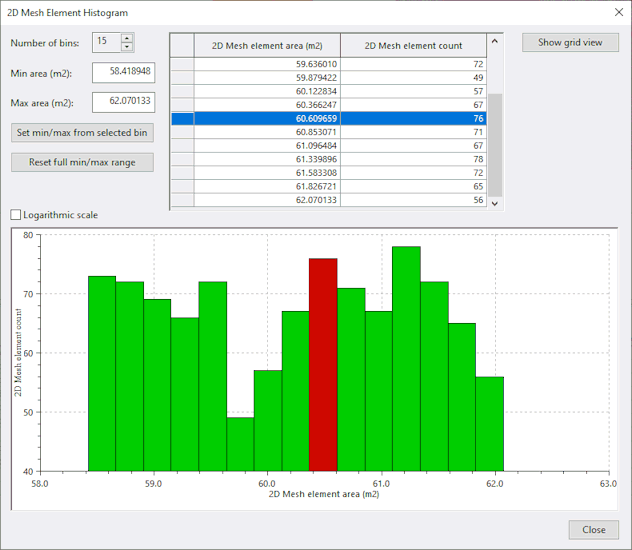

ICM uses the largest area of all 2D mesh element areas in the selected 2D zones as the initial maximum 2D mesh element area, and assigns 0 as the minimum area. It then subdivides the initial maximum area into equal-sized intervals (bins). By default, the number of bins is 10. It then finds the number of elements for each binned mesh area, and displays them in a
dialog as the 2D mesh element area/2D mesh element count histogram and grid. An example is shown below:
Both the grid and the histogram are selectable. If you select a row in the grid, the corresponding bin is highlighted in the histogram. Similarly, you can double-click on a bin in the histogram to select the corresponding row in the grid.

- Select the Histogram for 2D element areas option from the Model
Meshing menu.
The
2D Mesh Element Histogram dialog is displayed, which contains the 2D mesh element area/count histogram and grid based on the initial minimum and maximum area and number of bins.
Tip: If there is a very large range in element count values for different bins, check the Logarithmic scale box to display logarithmic rather than linear values on the Y axis.

Tip: As the purpose of histogram is to help you identify very small areas in the 2D mesh, you may find it useful to set the Max area to the Minimum element area specified for the 2D zone.
The grid and histogram are updated accordingly.
- For closer inspection of an area:
- Use the up arrow to increase the number of bins. The maximum number of bins is 100.
- If there is a particular area that you'd like to inspect further, select the applicable row on the grid, and then click Set min/max from selected bin.
Note: There must be a non-zero value in the 2D mesh element count column in the selected row.
Tip: You can use the Set min/max from selected bin button multiple times until it is no longer possible to drill down any further. The button is disabled when this occurs.
