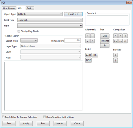

The SQL tab on the SQL dialog lets you build your SQL query.
A simplified version of the tab, without the spatial search settings is displayed when:
If you are familiar with SQL queries, you can type in a query manually (using the Field Type and the Field boxes to insert the fields you need). Details of the SQL statements allowed in InfoWorks ICM can be found in the SQL Syntax topic.
Alternatively, click on the Builder >> button. This displays a set of buttons representing the operators that you can include in your query.
You can represent constant values in the query by typing the name of a user macro instead of a value. User macros are highlighted in blue.
Tip: You may encounter a parsing error when you have included a field name which starts with a number. It is recommended that you place such field name between [ ] in your SQL query. For example, instead of entering SET 2d_pt_id = subcatchment_id, you can use SET [2d_pt_id] = subcatchment_id.
For information on the dialog buttons, see SQL Dialog.

Builder
Click the Builder >> button to display a set of buttons representing the operators that can be included in the query. Click the Finish << button to close the builder.
