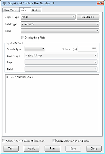

First we set the user field value in all nodes to zero. Before doing this, make sure the field you use doesn't contain useful information! |

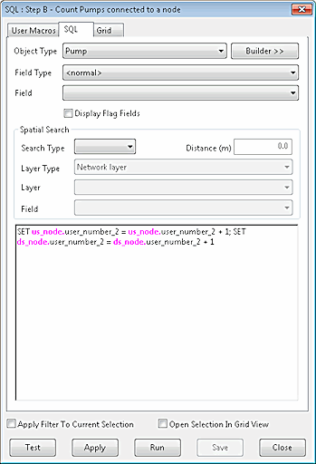

Now we count all the connections to pump objects. Note that the Object Type field for this query is set to Pump.

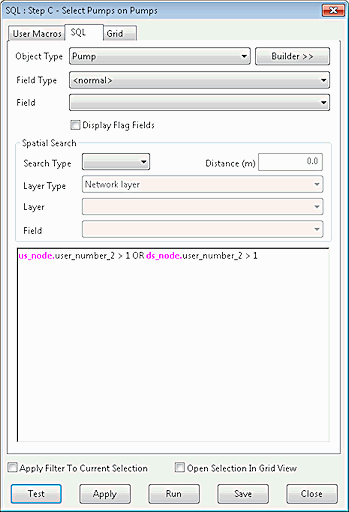

Next find all the pumps that are connected to other pumps. These will now be selected. |

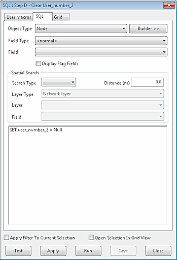

Finally, delete the count from the User Number 2 fields as we do not need it any more. |
