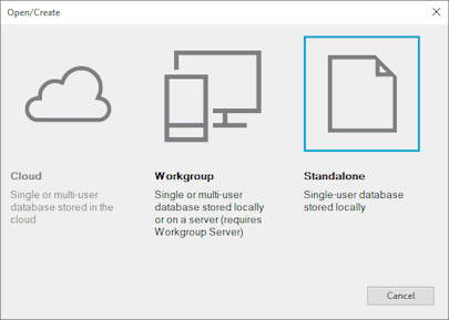

    1. Select Open Open/Create database from the File menu, and the Open/Create dialog is displayed.
    2. Click the Standalone image and the Open Database dialog for a Standalone database is displayed:

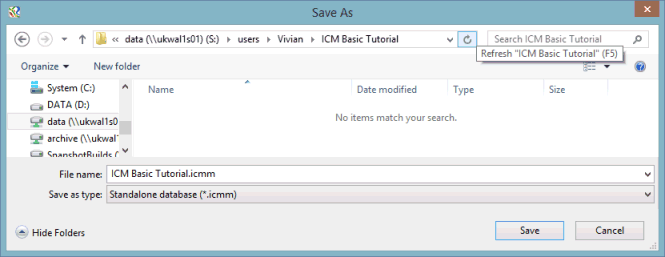

    3. Click the New button. A standard Windows Save as dialog is displayed.
    4. Set the location where the new database is to be stored, and give it an appropriate name such as 'ICM Basic Tutorial'.
      Create New Master Database Dialog
    5. Click Save. The dialog closes.

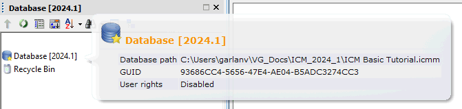

    6. Click OK in the Open Database dialog. The new 'empty' database should now be displayed in the Explorer window.
      You can see the name and location of the new database when the cursor hovers over the item in the database tree.

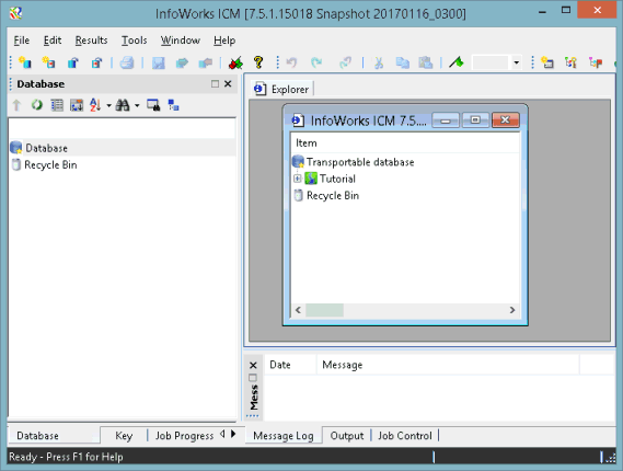

  3. Open the transportable database:

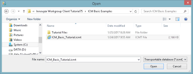

    1. Select Open Open transportable database from the File menu, and a standard Windows Open dialog is displayed.
      The transportable database is called 'ICM_Basic_Tutorial.icmt'. If there is more than one of these, please work with the one with the latest date.
    2. Locate the appropriate transportable database.
    3. Select the transportable database, in this case, 'ICM_Basic_Tutorial.icmt' and then click Open.
    4. The Windows Open dialog closes and the Basic Tutorial database is displayed in a Transportable Database window.
