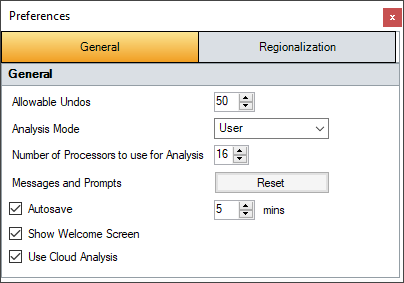

InfoDrainage™ supports running simulation processes in the cloud. See File Preferences to enable this option.
