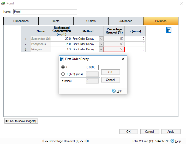

First order decay – with background concentration
Realistically some pollutant concentrations are not reduced to zero. Users are able to specify a background (minimum) concentration (Cback) below which the pollutant concentration will not be reduced.
The method is the same as for First order decay – without background concentration - other than the ability to enter Cback.
