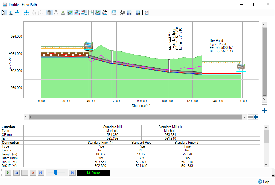

As soon as the first element on the path is clicked, a new Flow Path node is added to the Flow Paths top-level node in the Tree View. Double-clicking a Flow Path node will produce the Profile form. Right-clicking a Flow Path node will produce a menu that provides options to edit, rename, duplicate or delete the Flow Path, as well as view it in the Profile form.

Viewing a Profile
To view the Profile for a given Path either double-click the Path in the Tree View or right-click and select View Path.
