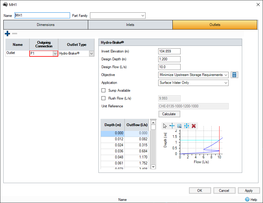

Invert Elevation  - The invert elevation of the control.

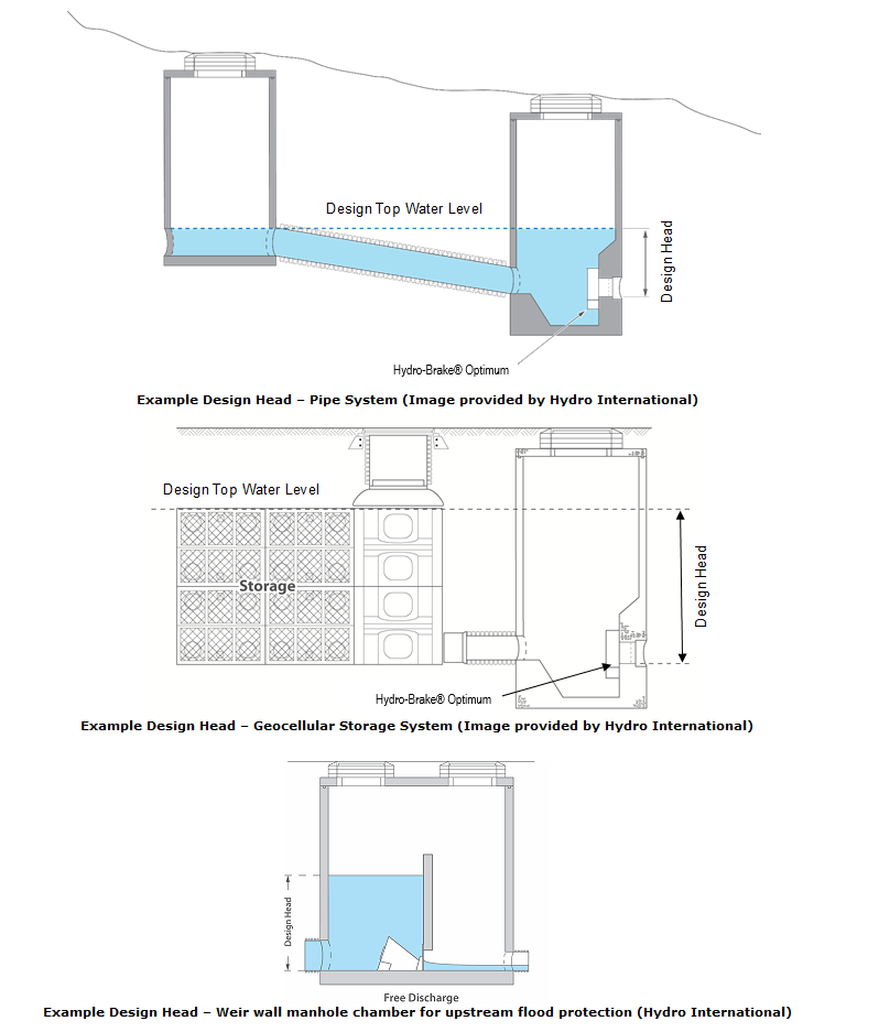

Design Depth  - The desired design depth of the control (where the vortex is fully initiated). This should be entered as a depth above the invert elevation of the control and will vary between different structures and manholes depending on the depth of storage structure and desired freeboard.
Design Flow  - The desired design flow of the control (where the vortex is fully initiated).
Objective  - The Hydro-Brake® design objective, see below for further details.
Application  - The Hydro-Brake® design application, see Hydraulic Characteristics below for further details.
Sump Available  - Indicates whether or not there is the provision of a sump to accommodate the flow control.
Flush Flow  - See Hydraulic Characteristics below for further details. If the checkbox is unticked, this defaults to the Design Flow.
Unit Reference  - This Unit Reference indicates the model of Hydro-Brake®.

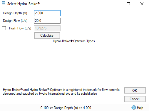

To see a list of possible units, a Calculator is provided:
Design Depth, Design Flow, and Flush Flow can be specified as before. Retrieving results via the Calculate button will return the Unit Reference and Outlet Diameter for each Objective.

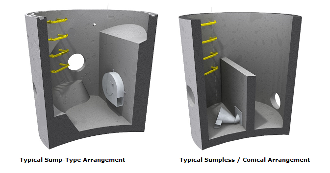

Sump-type
Surface/storm water only
BBA and WRc Approved.
Design objective can be specified (see Section 4.1 below)
Sump-type units require the provision of a sump to accommodate the flow control. Sump-type units are unsuitable for use in sanitary/combined systems.
Non sump-type
Sanitary/combined and surface/storm water
Non sump-type units do not require the provision of a sump to accommodate the flow control. Instead the unit is benched into the chamber. Non sump-type units are suitable for use in both sanitary/combined systems and surface/stormwater systems.

Generally all Hydro-Brake® Optimum flow controls should be designed such that the duty/design flow is not exceeded at any point on the head-flow curve.

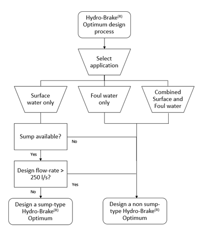

Selection of the most appropriate Hydro-Brake® Optimum Flow Control for a particular application depends on a number of considerations, including the type of sewer system, the hydraulic characteristic of the device, device clearances and overall physical dimensions. The program provides outputs for hydraulic characteristic and outlet size. Depending on the particular application of the Hydro-Brake® Optimum, the appropriate style unit is selected within the flow control design process.
The flow chart below provides information on the Hydro-Brake® Optimum style selection process taking into account the considerations of type of sewer system.
If a Hydro-Brake ® Optimum is not designed:
In the event that a Hydro-Brake® Optimum cannot be designed within the software, this is because the device is outside of the BBA & WRc accreditation ranges. This does not mean a Hydro-Brake® Optimum cannot be supplied, however, some additional information and considerations must be accounted for in the design of the device. Contact Hydro International for further information.
