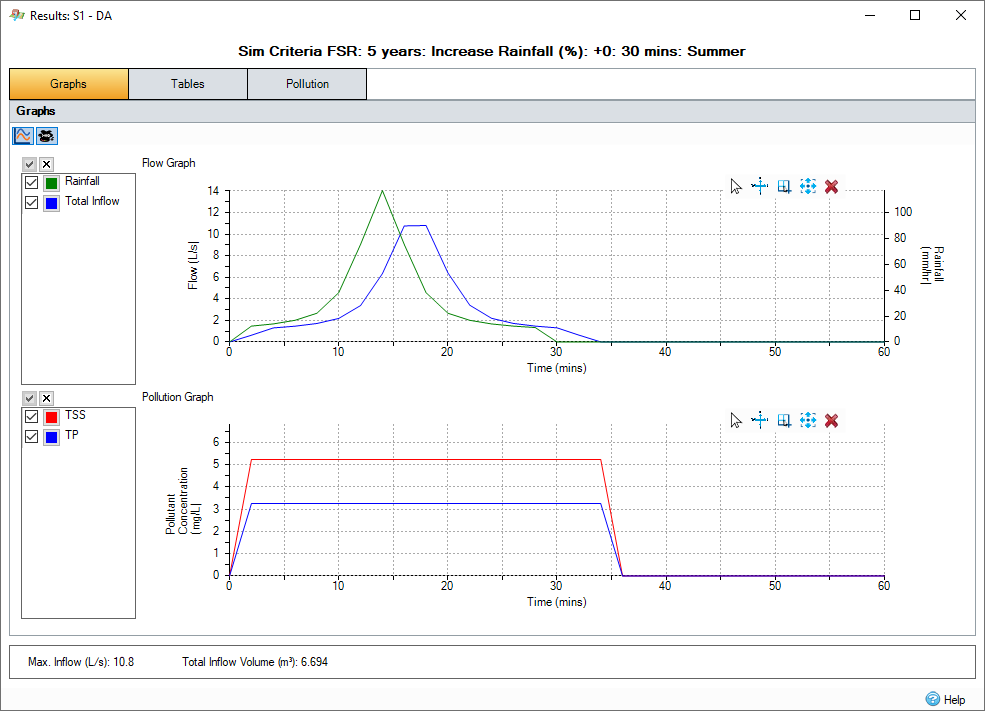

Graphs
Provides 2 graphs showing different aspects of the result, each of which can be turned on and off as required. For more information, see the Graph Tools and Results Graphs pages.
 Flows - Provides a graph showing the total inflow and rainfall against time. For phases containing only Baseflow or Input Hydrographs rainfall will not be available.
Note: The Runoff (Flow for Input Hydrograph) will be shown when the Rainwater Tank is active so the effect of this on the Inflow Hydrograph can be seen.
Pollution - Shows the Pollutant concentration from the inflow against time.

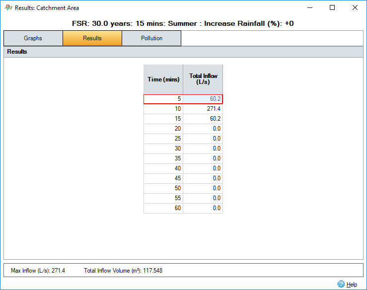

Results
Shows the Inflow rate against Time from the analysis of the Inflow .
Note: The Runoff (Flow for Input Hydrograph) will be shown when the Rainwater Tank is active so the effect of this on the Inflow Hydrograph can be seen,
The information is shown to a default number of decimal places, based on the unit. If you want to see more or less decimal places, you can select Increment Decimal or Decrement Decimal from the right click menu. This setting will not be saved between sessions.
Output Interval
The output interval comes from the value selected in the  Analysis Criteria . The results are averaged over the output interval period, for example if the Output Interval is 5 minutes and the Analysis Interval is 1 minute, the results calculated for the 1 - 5 minutes intervals are averaged to produce the 5 minutes result.

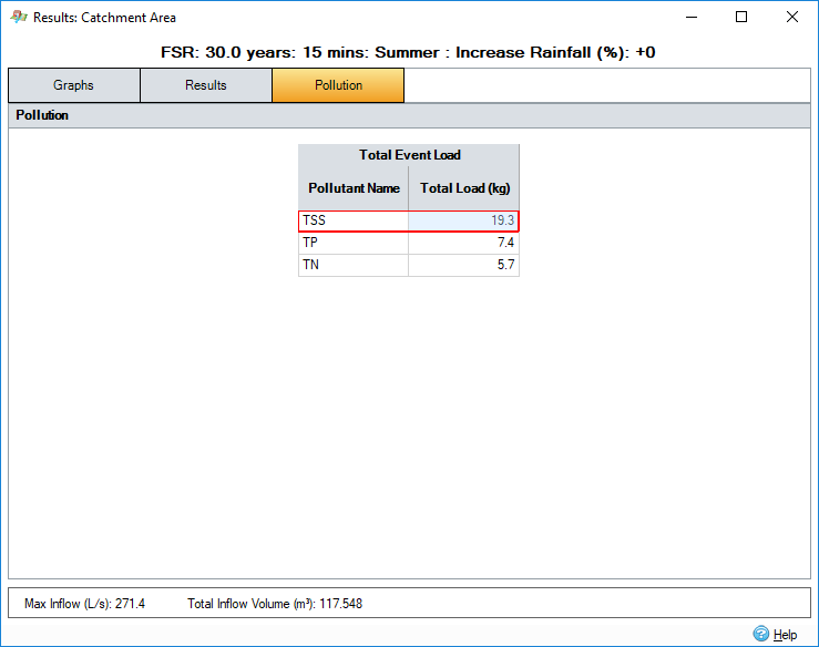

Pollution
Provides a break down of the Pollutant loads entering from the Inflows .
Max Inflow and Total Inflow Volume
Under all 3 tabs the values of the Max Inflow and Total Inflow Volume for the Inflow are displayed
