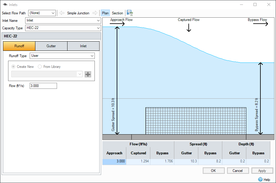

Inlets Form
The Inlets Form displays capacity details for Inlets.
HEC-22 Inlets can be sized, and display a results table and preview images.
All Inlets

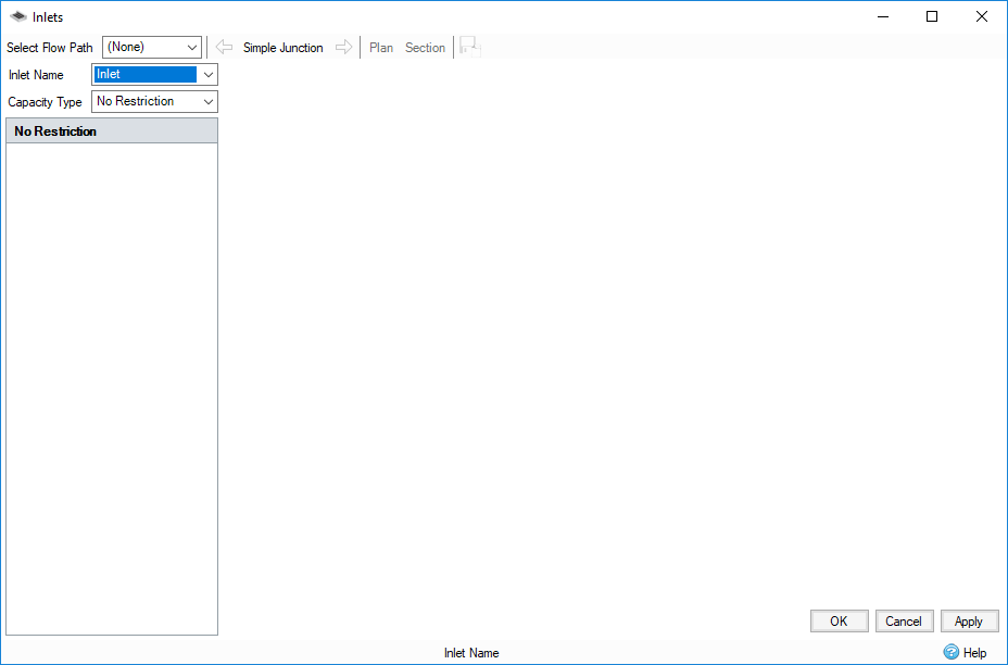

Toolbar - Contains tools for the selection of a specific node within a flow path, and buttons for switching the view of the HEC-22 preview image.
Inlet Name - Where a node has multiple inlets, this drop-down list can be used to select a different inlet.
Capacity Type - The capacity type of an inlet can be modified from the inlets form. For more information, see the Capacity Type section of the Inlets help page.
HEC-22 Inlets
Certain components of the form are available only to HEC-22 Inlets.
Preview Image - The image in the upper right of the form. This provides diagrams of both a top-down plan view, and cross section view of the inlet, and water passing over the inlet. The image is not displayed for HEC-22 inlets that are In Sag.
Table of key values - Contains key values of flow, spread and depth.
