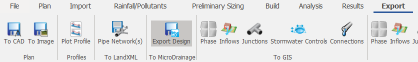

  1. In the Export ribbon, click the Export Design button.

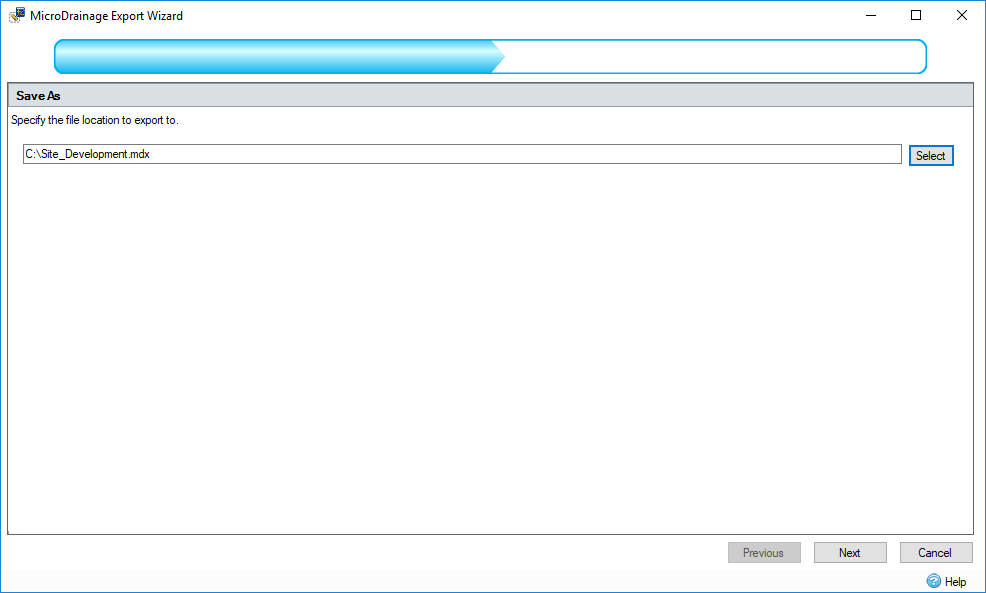

  2. Click Select to specify the location where you want to save the exported file. Give it a file name and then click Save.
    The file will be saved as a MicroDrainage (*.mdx) file.
  3. Click Next.

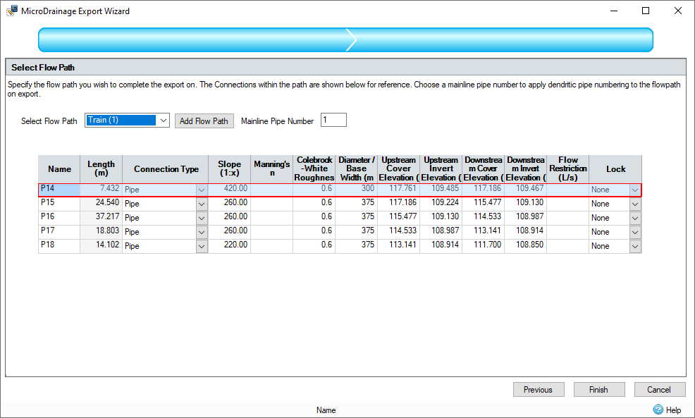

  4. Specify the flow path that you want to export by selecting from the Select Flow Path drop-down list.
    The connections within the path are shown in the wizard for reference.
  5. Choose a Mainline Pipe Number to apply dendritic pipe numbering to the flow path.
  6. Click Finish.
