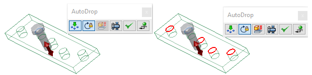

Place bolt into patterned hole
  1. Pause the cursor on the hole edge. Besides the part preview, a question mark and a context-sensitive icon are displayed on the cursor.
  2. As you pause the cursor over the target geometry, the part preview automatically resizes to use the closest match from the available part sizes. A tooltip displays the part name and the updated part size. If a part size corresponds with the target, the cursor changes to green check mark.
  3. Click the target hole edge.
    The AutoDrop toolbar is displayed with Follow Pattern selected by default. Switch off the button to insert a single component instead of a pattern.
  4. You can drag the length grip to specify the bolt length, or double-click the grip to select a length from the list. Only standard Content Center lengths are available.
  5. Click Apply to insert and mate the bolt.
