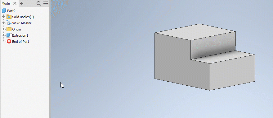

Part Folders
You can add folders to organize and manage features in a part model.
part browser folder
In the Part browser, right-click a feature and select Add to New Folder. The selected feature is placed in the new folder. When a new folder is created it displays in edit mode for naming.
Part Folder Commands
part folder commands
The following commands are available in the right-click menu of an existing part folder.
Drag and drop folders to manage their order in the browser.
