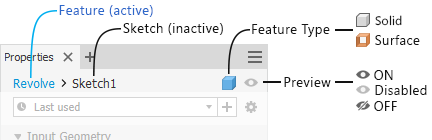

At the top of the property panel is the breadcrumb. You begin with feature definition but can quickly move between feature definition and editing the sketch by clicking the breadcrumb sketch text. Return to the feature environment by clicking the breadcrumb feature text.
  1. To the right of the breadcrumb is the feature type. The type determines which options are presented in the property panel.
    Specify the feature type:
    • Solid (default) - Creates a solid feature from an open or closed profile. Open profile selection is not available for base features.
    • Surface - Creates a surface feature from an open or closed profile. The feature functions as a construction surface on which to terminate other features, or a split tool to create a split part, or split a part into multiple bodies. Surface selection is not available for assembly revolves or primitives.
    Click the icon to switch to the other feature type.

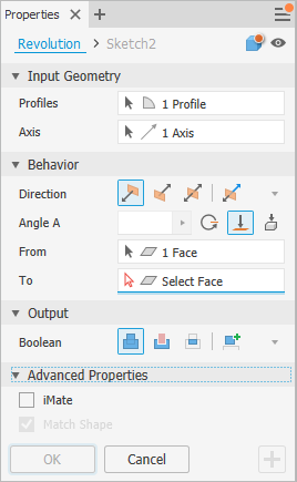

  4. Specify the Behavior parameters.
    1. Direction
      • Default: Revolves in one direction only.
      • Flipped: Revolves in the direction opposite of Direction (default).
      • Symmetric: Revolves in opposite directions from the sketch plane, using half the specified Angle A value in each direction.
      • Asymmetric: Revolves in opposite directions from the sketch plane using two values, Angle A and Angle B. Enter a value for each angle. Click Flip to swap the angle values.
    2. Angle
      • Angle A: Specifies the revolve angle between start and end planes. Dragging the manipulator will modify the value at 5 degree increments.
      • Angle B: Specifies the angle for the secondary direction. It displays for the Asymmetric direction.
      • Full: Revolves the profile a full 360 degrees.
      • To: For part revolutions, requires an ending face or plane on which to terminate the revolution. If the termination face doesn't intersect the revolved feature, the face is extended automatically to create the feature. Use the Minimum Solution option to help resolve.
        • Extend face to end feature - automatically activates when the To or To Next selection does not intersect the revolved profile. You can also manually turn on or off the option.
        • Minimum Solution - when options for termination faces are ambiguous, specifies that the extrusion terminates on the closest face.
        For assembly revolves, you can select faces and planes that reside on other components. To be selected, work planes and work points must reside at the same assembly level as the assembly revolve you are creating.
      • To Next: Requires an intersecting body on which to terminate the revolve feature in the specified direction. Use the Terminator selector to select a solid on which to terminate the extrusion and the direction options for the revolved feature.
      Note: Use the From and To options to get the same result as the Distance from Face and Between methods in prior releases.
    3. For multi-body parts, click the From Selector and select the participating body.
