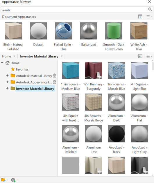

Appearance Browser
The Appearance Browser provides access to create and modify the appearance assets within the document, and to access the appearances located in the available libraries.
For example, the Appearance asset Generic includes the following properties:

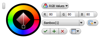

Adjustment of appearances
Note: This manipulator is enabled when the View is set to Render Quality mode.
When you require a different textured appearance on a specific face, use Adjust Appearance and Texture Manipulator. You can modify the appearance of a component, feature, or face. The two devices provide different levels of appearance asset interaction.
With Adjust Appearance, you can modify the appearance assignment, color, and texture mapping.
Texture Manipulator
The Texture Manipulator provides in-canvas tools to move, scale, or rotate the appearance texture on any face. While using Adjust Appearance, when you select a textured appearance, the Text Manipulator displays.
